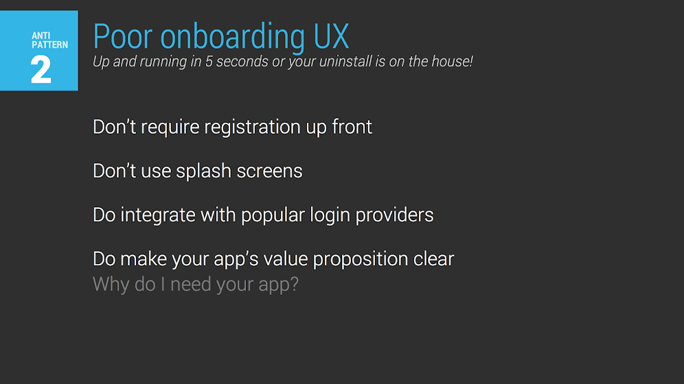

Sempre da Roman Nurik: https://medium.com/design-ux/f905a45b54dc
And as for the splash screen, well she didn’t open the app to stare at the logo, however pretty it may be. Every millisecond you’re not showing content is a millisecond that the user has to wait for something. We wait enough in our lives: we wait for the train, we wait on line at the grocery store, and we wait—often impatiently—for our significant others while they’re busy getting ready for a night out. We shouldn’t exacerbate the problem when the platforms we’re building for give us the necessary tools to avoid it.
Per finire, è stato considerato fra i 10 peggiori antipattern di android, al secondo posto.
(Fonte Google-AIDA, Android Design in Action)
